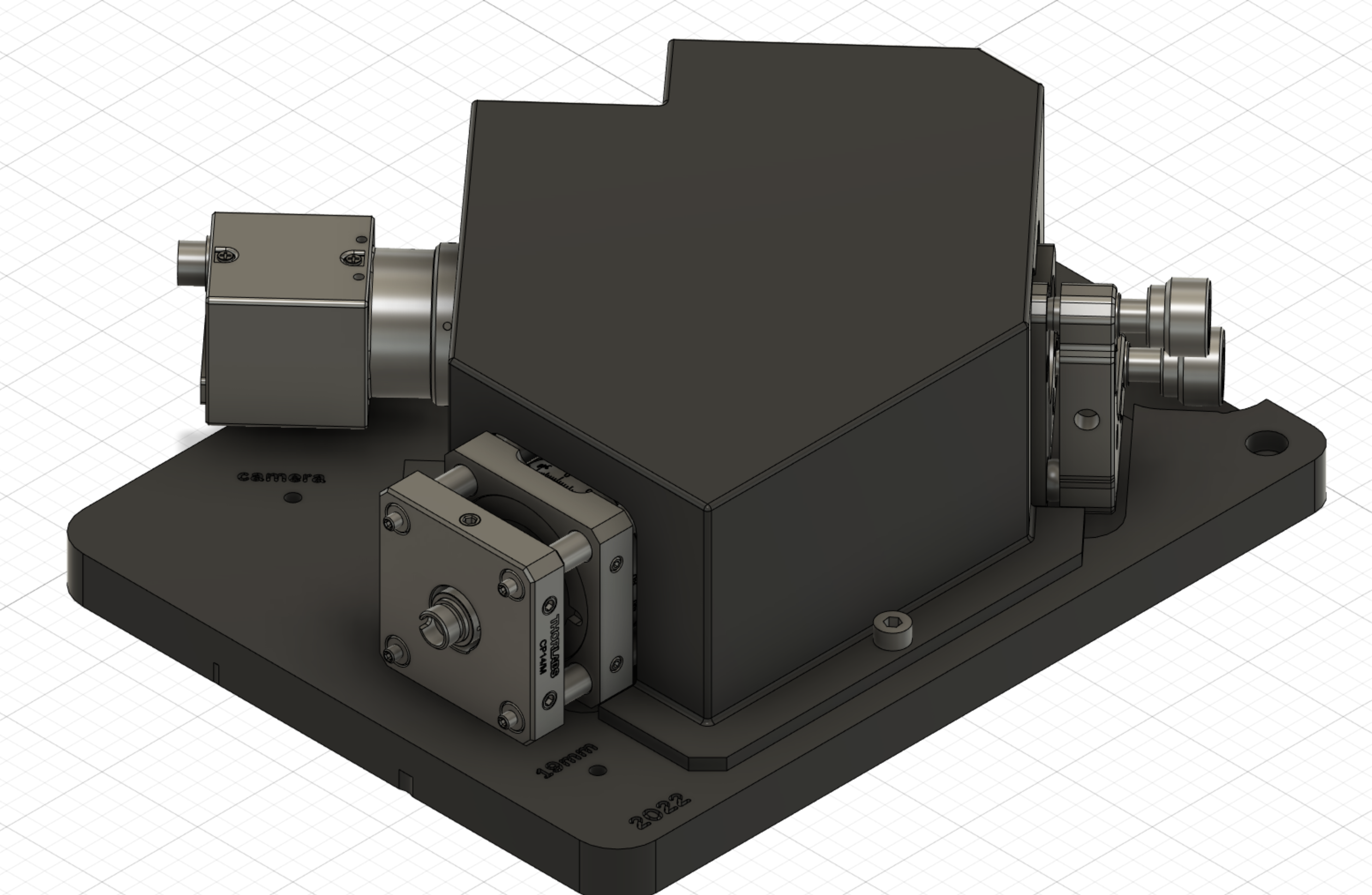

- Screenshot 2023-03-27 205951.png (2.68 MiB) Viewed 35444 times

They also look alot like the ScienceSurplus spectrometer that I tested a few years ago.
nb to save extra $$$ in your design, replace directly the rotation mount with the slit by a regular mount with the fiber connector -- the fiber core diameter will act as a slit (use a 20-50 microns core depending on the resolution you want).
That's how I use to do for straight spectrometers. The reason I'm using a slit in openraman is because imaging a spot on a slit is 1 dimension easier than imaging a spot on a tight fiber core/pinhole
Re: Interesting other forum threads on low-cost raman
Yes it is the same (link for anyone interested). Science Surplus has ran out though but they are still floating around ebay.
That's interesting point regarding the slit. Is a collimation lens needed after the fiber then or would the achromat doublet just focus the light straight from the fiber?
So it would just be fiber -> doublet -> diffraction -> camera objective -> camera
Yes that's correct -- you can see the bare fiber as a disk source with a cone whose half-angle is given by the NA of the fiber. So a lens in front of the fiber is sufficient to create a collimated beam.
